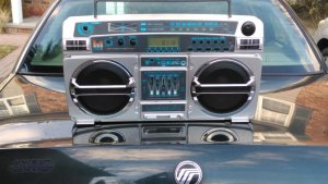

I picked up this model for a good price in excellent condition with remote. The problem is the volume doesn't want to go down with the volume knob, only goes up when turning down. Works fine with remote. This has one of those infinite knobs that just keeps turning. Can it be cleaned like the older pots that have a min. And max. Setting? Worst case I have nothing to lose by trying.
I used it for family Christmas gathering. Volume at max and just controlled the volume from my phone which was sending the bt signal. Worked great and family loved it.
By the way it sounded like it was under a seat cushion when I first played it. Very disappointed. Then I found the eq button on remote and turned on loudness. This thing came alive!! Very pleased with the box. My sixth Lasonic. Is this one of the rarer models? It grew on me, the silver color.
