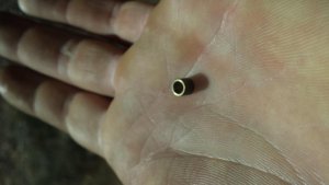

Replacing the belts today and found this floating around, anybody know where this goes? I probably should get the service manual for this thing!
Matrixambience
Josh!!! You need to put that back onto your cassette player! It's a spacer that goes under the plate that holds the main flywheel into your deck. The one with capstan roller with big flywheel. It's a variable adjustment screw with that bushing under the plate. It gets placed under that diamond shaped plate and it i goes in the upper screw mount towards the top of the radio when setup normally. The bottom screw is more fixed on that post. You get me?
Josh9994
Okay, I know where it goes now. The previous owner took it apart. I didn't see the nylon capstan washer in there so I'm pretty sure he lost that so I got to look for one somewhere.
Matrixambience
Wow! So you getting fixed up with new front case and speakers? Hope you can get it fired up. Those little nylon washers I suppose are a necessity since it does two things. First it acts as a washer on other side of flywheel to keep the capstan from being too sloppy going in and out of bearing race, and also a grease/ oil bearing barricade so no oil wicks down the capstan onto tape material. Maybe you can find a beat up cassette player somewhere to take one of them nylon washers from it?
Josh9994
Yeah I am working on getting it up and running someday! Just wondering if there is one between the capstan and the bearing race? Did your 9994 come in the mail yet? I'm sure it will not be in as bad of shape as mine!
Matrixambience
Ok. You mean a thin bushing between flywheel side and entering the bearing sleeve race? I think it has one molded onto plastic housing of deck. I just put a dab of phonolube on that area and installed flywell with capstan in race while using a dental hook pick and held the small main belt away as I installed flywheel, then snapped the belt on first small step on flywheel, which you cannot see when flywheel is installed on backside.
