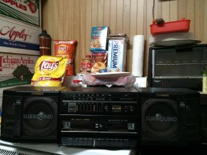

I'll throw up a photo,the thing is a beast.😮😎📟📻💳
Ghettoboom767
Here's the Berechea Fisher,over 30" wide and did I say-it's bi-amped and
Bi-wired!

crazygamer
That´s a nice piece, i´ve worked on one like this, it was a success. Great box which is easy to service. :w00t: :thumbsup: Good luck with this piece :yes:
ralrein1
Yep,that's her.I've got the same one Fisher PH-W803BA.Paid $20.00 for it at Goodwill.Tape counter belt for deck 2 was gooified.All other belts were in the limp rubber band stages.I too am waiting for belts to show up,any day now.Replaced the woofers in mine with ones from a Panasonic rx-ds620.Now she almost thumps.Also put some polyester batting from one of my pillows into the speaker boxes.That also seems to have helped.Still have an annoying vibration on left side,I think its that plastic strip between the woofer and midrange & tweeter.Good luck with your fixes and let us know how she turns out.
