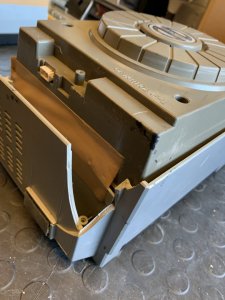

Excited to own the VZ-2000. I'm incredibly intimated by attempting to repair this beast. I did use to do some minor latpop repairs. I'm comfortable opening things up. I have gone through the strip down file a few times now, plus watched a few videos. I haven't opened it up yet. A few questions.

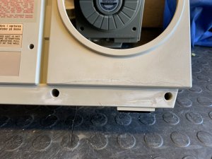

First, any suggestions on how to repair this damage on the side of the box? VZ-2000 side damage. I know it will never look new again. I just am hoping to repair the gaping hole.

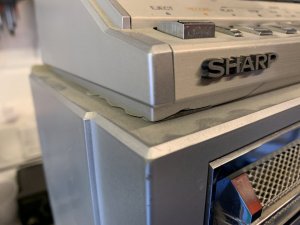

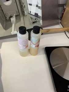

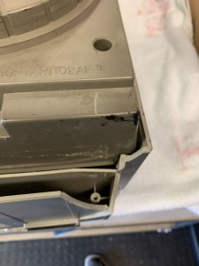

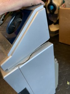

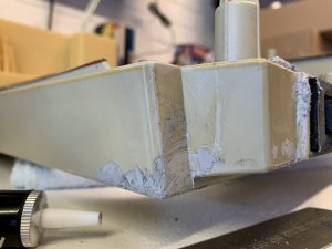

Here are some pictures of one of my VZ2000s that had a lot of damage.
I used a combination of an 2 part epoxy glue to repair and used pieces of plastic to reinforce on the inside over the cracks to add strength.
where I had some plastic case missing I used a plastic resin to replace b Forming the shape with bits of plastic sheet then pouring the plastic resin in place. Finish off with a plastic filler.
