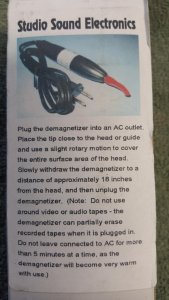

I bought this demagnetizer some time ago and have never used it

Just found this New old stock at my tekkie's shop today. Thought it would be good to have one since I've so much vintage audio.
There's a little info on the packaging that might help.

Demag'ing a tape head is part of regular maintenance for good decks. When a head becomes slightly magnetized the magnetic lines will blur the magnetic signals picked up from the tape medium by the heads. This will affect treble response & stereo imaging making your tapes sound slightly muffled & sometimes hollow.....Basically, a tape demagnetizer has an electro-magnet inside which uses the 60Hz AC to switch polarity, back & forth which un-magnetizes the heads. That's why it is important to slowly remove the demag tip from the heads slowly while it is still on to fully do the trick right....then you turn it off or unplug the device....
Cpl
One very important reason to do this is that a magnetized head will ruin your good tapes as the stray magnetism will permanently attenuate the highs on those tapes.
