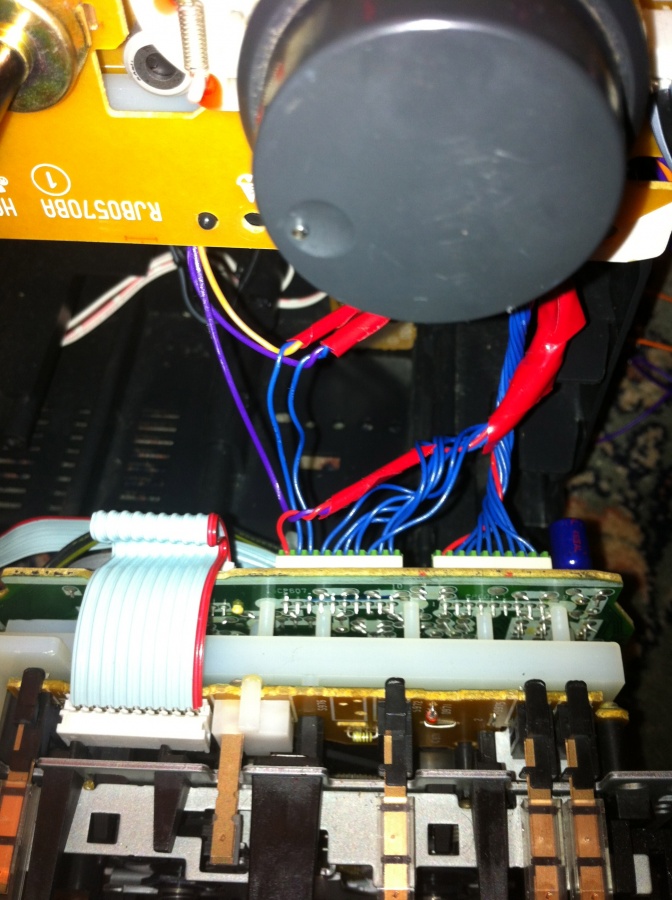

here are some pics guys... the first pic is where i spliced the wire, about an inch away from the tape deck. the two wires at the top are left and right channels, leading to the main pcb, the one single wire is the ground. the other electrical tape is just holding together the remaining wires keeping it tidy.

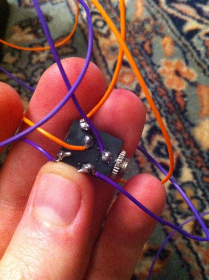

the other pic is of the socket... being a closed circuit there are five terminals, two sets of left/right and ground.

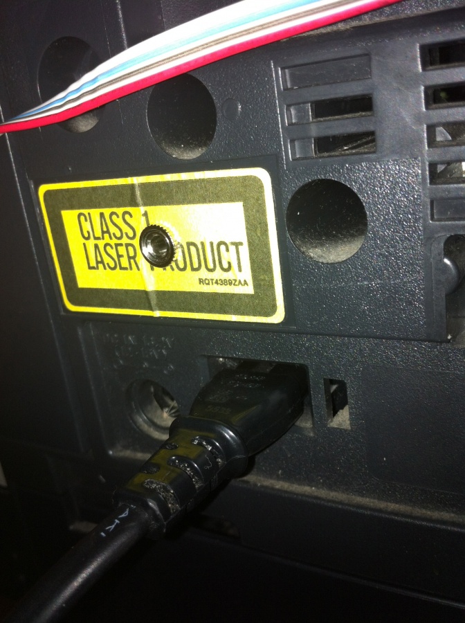

also posted a pic of the jack flush mounted on the rear of the unit. there might have been better places to mount it, but it would have required removing more boards and wires... i didn't want to in fear of stuffing something up. where it is now was the most easily accessible place.
