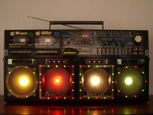

DISCOLITE needs help
ViennaSound
Anybody can help me?
Need the specification (Volt/ampere) of the speakerlights.
Is in this box 1 wrong lamp (strong)
or 3 wrong (weak)? :blush:
Also needed:
Anybody owns the missing labels "audio visual"
Or can give me a good quality close up shots, for reproduction of paper? :smooch:
ViennaSound
Labels are printed out now on a strong paper.
Then laminated. :yes:
Should fit.
a few LEDs fail, must look why.
And implant the correct lamps in the speakers.
Grills new painted black and a new aerial.
Big contact cleaning.
Some work, but it´s worth :thumbsup:

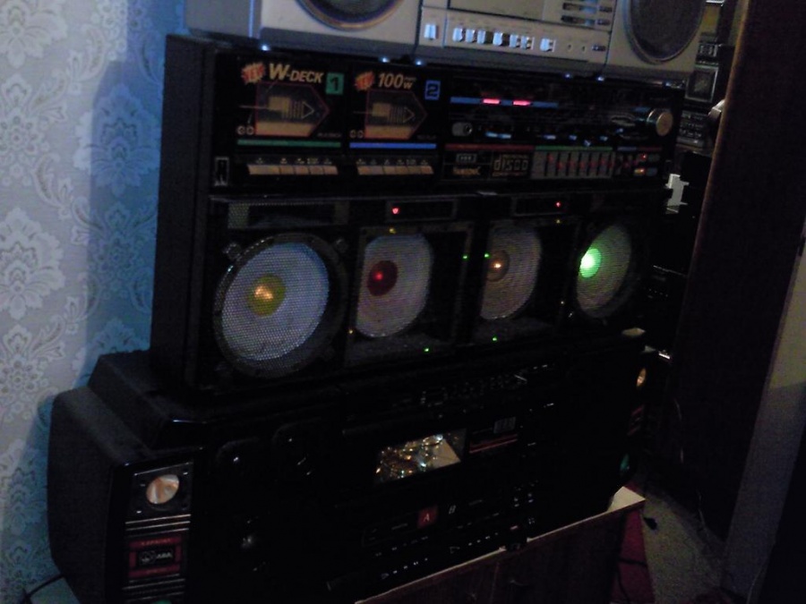

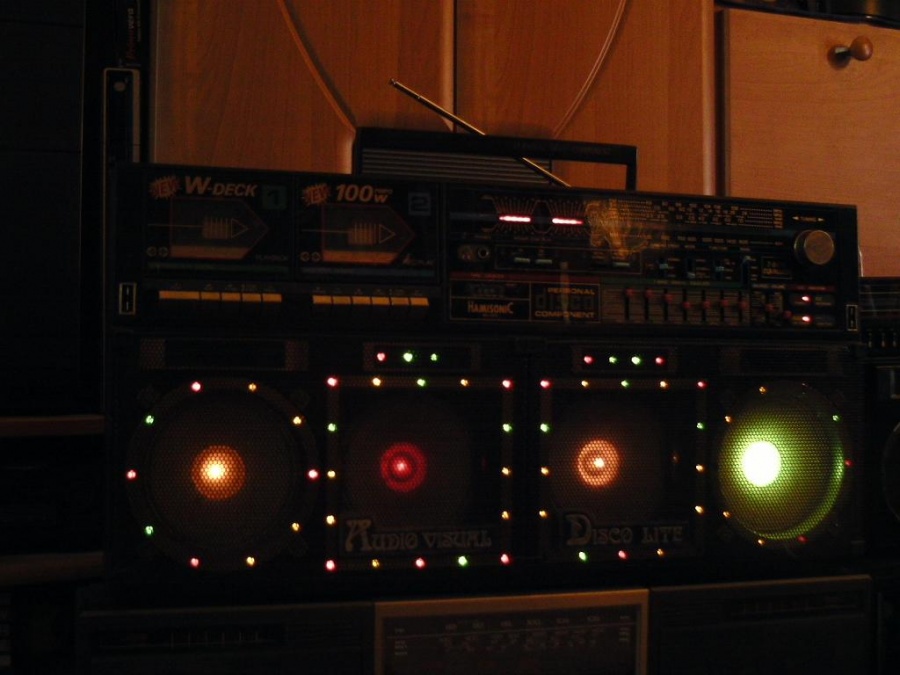

working
as you can see, the right one is too strong (or the others to weak?!?) :hmmm:
only a few LEDs are failing

and monchito is so right about the leds --
they are each dependent on a string of others that are
wired in some wacky // random set-up :huh: :dunce: :annoyed: :-)

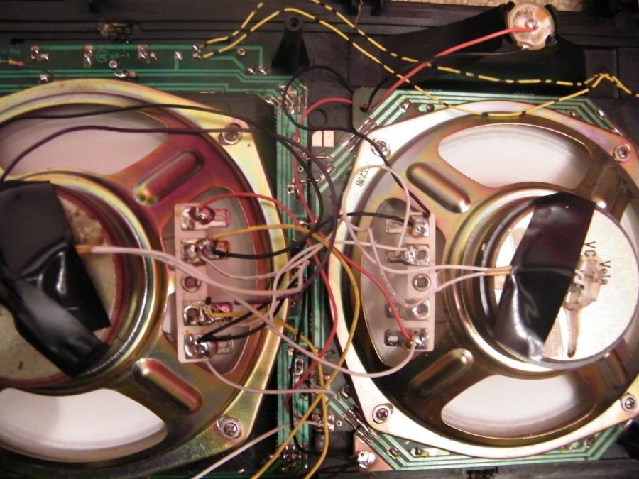

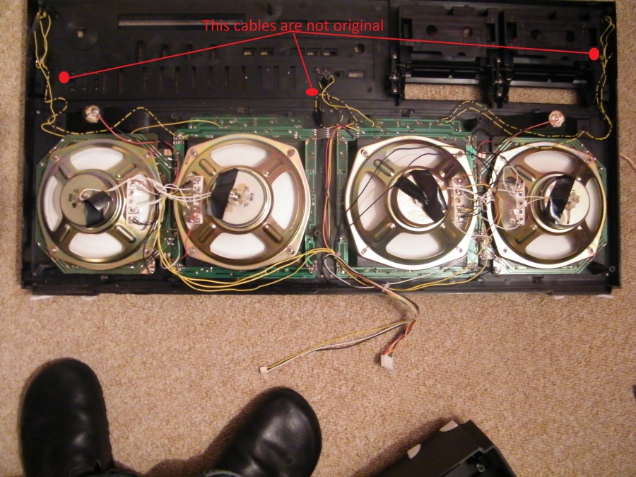

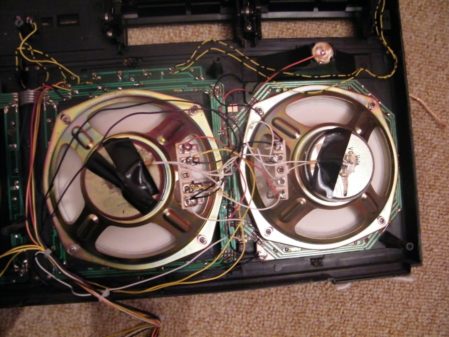

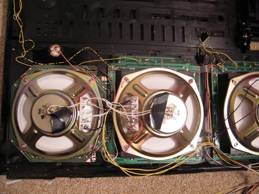

Looked inside, the 3 weak ones must be wrong.
you can see, anybody has worked on it.
The strong one is looking original (cable).

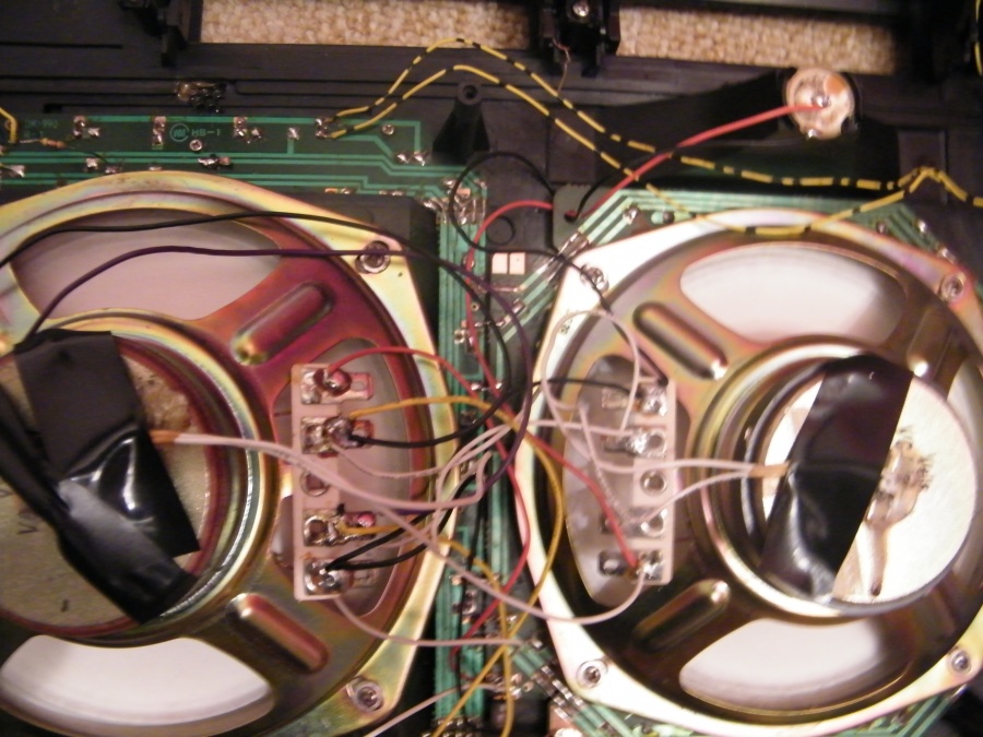

AK74

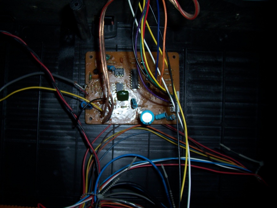

Here are some pics from the inside of my Discolite...
but my Breakdancer is a little bit modified with some extra LEDs
(the yellow/black cables are not original)
I hope i can help you...

Have you tried taking out the bright woofer globe and putting it on one of the other 3 dim one's plug, just to make sure it's the globe?
The globes inside are pretty standard, I'd probably find something as close as possible at a local electronics shop and then replace all 4.
Best of luck replacing the 6 dead LEDs. Those ones in the corners of the square array are real pains to replace.
