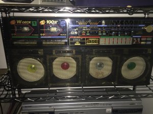

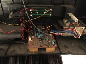

Hi I have one of these just recently bought. Gave it a very good deep clean. My only problem on this unit. Is the fm signal loads of interference when tuning. Hissy scratchy noise when tuning. Any idear be very welcome.
Hopefully when you clean yours there's not to many problems.

Luckily these power switches are on many other Boomboxes and can be found on parts units. I used one off of M90 parts box but just about any radio with push button power switch should work ;-)
