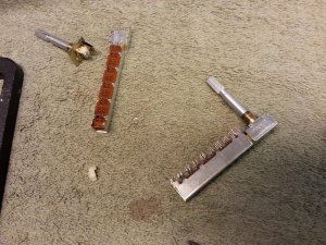

What would you use to lube the gear switches in the Lasonic 931 function switch?
It's plastic gear on a plastic track, but it also houses the electrical contacts of the switch?
Dielectric or Lithium Grease or something else?
Dielectric grease is often too thick, so lithium might be better. In either case, only "lightly" lube the gears. Any excess that gets on those thin foil feelers will likely spoil the contacts. I personally like to use synthetic silicone grease. Try to use grease that mentions plastic safe. Some lubricants like Vaseline causes swelling if rubber and others makes plastics brittle over time.
OK, so just a tiny dab of lithium on the gear and keep it out of the contacts.
There is some sort of brown grease or something on the contacts. Anything you suggest for those?
Craig has a Faderlube product that is thicker than oil but not as thick as your typical grease. Check out at Caigs website.
Actually I don't recommend any grease on those contacts. I use 100% Caig deoxit D100 Gold which is like an oil and is a surface preservative.

I understand this, I meant more using is a a grease/lube for moving parts, as it is safe for plastics, Chris mentioned a lube for the gear itself, then also for the contacts. This would work fine, (I believe) for just the gear. I should have clarified.
But yes, I understand if this particular stuff were to get on the contacts, that could be a problem.
