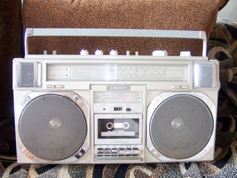

Crown csc 950 tweeter
lazanas
Ummm, really??? :thumbsdown: two pieces are melted to hold it :dunce:
How you suggest removing this ? :hmmm: i need to clean this babe :drool:
Hammer :judge: :judge: :judge: :judge: :judge: :judge: :judge: :judge: :judge: :judge: :judge:
You can use long nose pliers to break edges or exato knife to cut then when you replace you can remelt other prongs with solder iron ;-) good luck :thumbsup:
A solder iron with a big flat tip and you essentially "cut" that plastic weld off, or get a tiny butane torch lighter and heat up the plastic welds while prying up gently on the speaker. OR, you could try to drill the "head" of the weld off :-/ .
