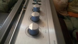

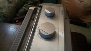

Hello Members and Followers,

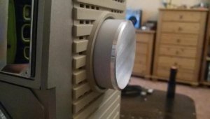

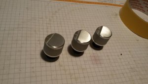

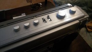

im proud of my new old Crown 950. But theres a thing that i dont like. My 850 from Crown looks much better and
fells better with full metal knobs. So thats the reason why i made my own full metal knobs for the Crown 950.
Plastics are not my favorite.....So cause im owner of a lathe and a mill i made these knobs by myself.
Not easy but the result speaks for its own:
I've blasted the sides with korunddust. Looks absolutely perfekt. Got also little inserts made from POM cause that the knobs
can be fixed on the poti's.......
got the originals here for sale. If anyone need the plastics let me know, and if anyone need full metal knobs also,
:thumbsup:
The knobs are not painted......and the surface on top is brushed.......

Oh Damn they look so good! Metal knobs are so much more tactile than plastic.
I'd be interested in a set, pm me please. Great job man

THX :) looks better than the originals.....when i can help with this or that let me know.....i build so many things....
for example i made own pinch roller for my sharp gf8989 or for the both crowns 850 and 950.....
not so difficult but they works fine now :yes:

Cool thx, i only used a sandpaper with 400 grain size. this special sandpaper lay on a straight surface and with a special movement
you made the special kind of surface, but its not easy cause you have to keep it for the abrasive particles.....so you have to do clean the sandpaper
after each 2 movement. everyone can make itself....but i have also special tools for my lathe....so many things are possible, my biggest passion is to made
things especially with my lathe and my mill.....and if anyone need help or need parts what i can make.....let me know. i think its important to give something back
to other people when i can. its good for my karma :) and a smile in other faces can give us so much more than only money or whatever.....
additional info: the sandpaper is especially for metals.....not the ordinary from the toolsstore.....

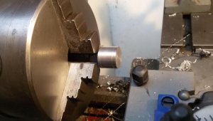

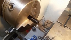

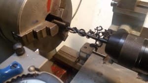

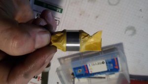

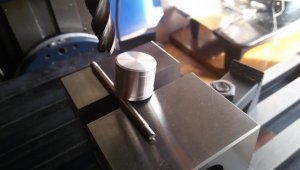

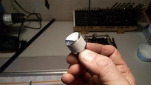

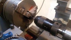

So dear members and followers.....

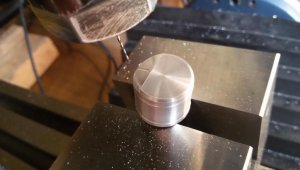

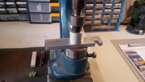

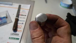

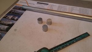

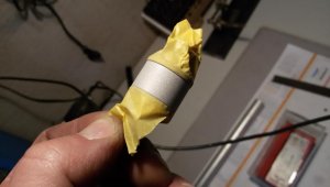

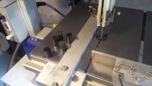

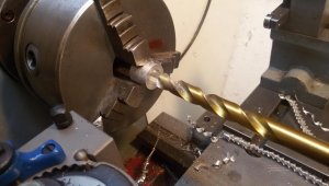

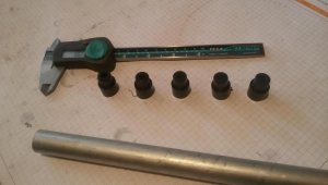

Here some pictures from how do i realise the knobs.....i have make some new to show how it goes
first the inlays, then center it and drilling with 5.6mm after that i turn the correct and nedded diameter with a little oversize to
press it in the aluknob. but therefore i must ream the hole for the potishaft with a special cone reamer.
then i make the outside finish from the aluknob. et`voila after 2 hours the knobs are finished
