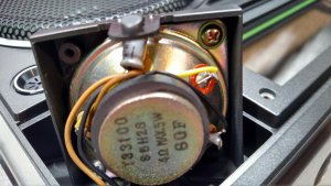

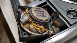

Yeah, my question about the sound wasn't worded very well.
I was questioning if someone had 10s (if they were installed from the factory that way) and replaced them with 4.7s, how much of a difference there was.
After originally finding the discrepancy, I did some research on crossover caps since I didn't really know much and arrived at pretty much the same conclusion as you, the 4.7s should be the better choice.
At first, I thought maybe they were replaced being Rubycon caps instead of Sanyos but then I thought that possibly Sanyo didn't make this value in bipolar caps.
If these were replaced, whoever did it did an excellent job of making them look factory right down to the brown glue adhering them to the speakers.
I'll Include a couple pics of the 10s.
I'm going to buy some 4.7s to replace them.
Thanks.

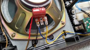

Just an update in case someone else runs into this in the future.
I got my capacitors yesterday and soldered them onto the woofers similar to an M90.
I bought some Panasonic 4.7uf 250v polypropylene caps.
I removed the two 10uf caps from the tweeters and soldered the positive wires onto the positive speaker terminals.
Again, like on an M90, I glued the 4.7s to the woofer magnets and let it sit overnight.
I tried it out today and the tweeters are sounding great with lots of treble.
