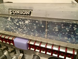

Conion with splatter
GHETTOBLASTER4LIFE
Normal cleaner doesn’t do anything to take it off.
Any advice ?
Should i take it completely apart ...iv never done before

Novus 3 followed by Novus 2
Or if that doesn't work, use a headlight polish kit with an electric polisher
GHETTOBLASTER4LIFE said:
Hey bill , turtle wax with no success.
How you been man ?Its not paint
I’m good brother how you been? You can try stripping it down and soaking it with mild soap and warm water. If we know what it actually was it might be easier to give solutions.
the seller told me it might be car carb cleaner :bang:
If it is then only thing that can be done to tuner window is buffing out the marks. Like said before the headlight refinishing kit will work. As for the case either leave it or paint it
GHETTOBLASTER4LIFE
i read it can be wet sanded and clear coated on the glass

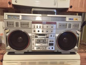

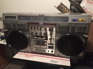

I used the headlight wax and it came out alot better , a long way from perfect , thanks to everyone that helped out .
Nice to get back into it, its been awhile for me lol
Not bad

That look a hell of a lot better ,Rock on man!.
Glad you're back and with a conion ,sometimes you get better boxes when you take a break from collecting and fixing then bam out nowhere you're back.
