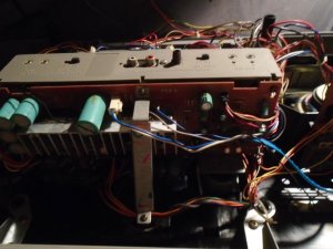

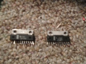

Hey thanks for the info. I think i just made matters worse. I tried to replace a leaf switch on the lower deck and i saw smoke coming from the pcb 2 board and saw that one of the amp chips burned up. After changing the amp chips i still dont get any music, nothings working now, just a loud humming sound when power is pushed. Is it possoble i burned something else up?
