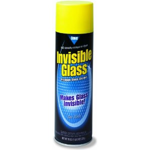

JustCruisin
This stuff is the bomb! It has a light foaming action that dissolves finger smudges and light grease without hurting the lettering...
Tuner windows, plastic casings, cleans the shyt outta everything! :yes:

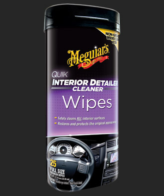

I love the Quik Interior Detailerâ„¢ Wipes
After using it wipe it off with a clean microfiber cloth. I use it on my car GPS screen, instrument cluster cover and all. It works fantastic
