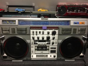

This landed this week from a well known member of our community......cheers Dave

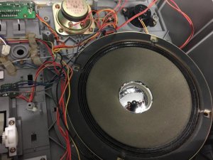

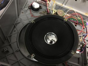

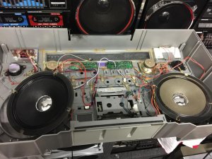

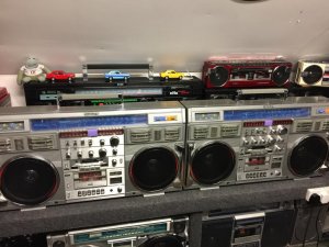

Nothing needed on this beauty apart from a speaker refresh as they was a bit faded,I give the grills a refresh as well!
A lot of work involved to get to these speakers but worth it!
For some reason the pics loaded the wrong way round!

That conion has different tweeters than the usual ones I have seen. First time seeing that setup in a conion/clairtone , looks awesome though.

I'm curious what you're used to seeing, those tweeters look exactly like every set I've ever seen inside those boxes. The right tweeter has a foil-backed sticker to block its energy from the tuner board.
