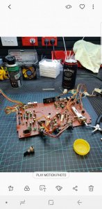

Hi all.
I'm feeling like it could be a bad amp chip but I'm hoping someone could shed some light on my issues with the sound on a C100 that I'm restoring.
The main issue is that both speakers only work on the 'wide' setting, stereo and mono the right speaker works.
This is what I've observed.
Playing cassette or AUX in:
Stereo and Mono= only right speaker
Wide= both speakers work fine except its louder when balanced to right channel.
Radio mode:
Mono= only right channel plays fine
Stereo & Wide= No out pur from speakers.. faint sound only from right channel
Headphones:
Only balanced to right does it work, (on both earphones (might be dodgy earphones)) No sound when balanced to left.
Wide, stereo, mono has no effect on this.
I'm thinking it could be the amp, although I am getting output from both speakers in wide, so I'm a little confused.
