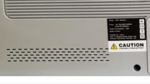

However, as a beach box the Brooklyn has a few issues that make it not so beach friendly. For one the CD slot up top is a magnet for sand and will likely send it right down into the CD mechanism if not protected by tape or towel. Also at the bottom of the stereo in the rear are the ported bass reflex slots for each of the lower speakers (one on each side). Little did I know how much sand had got in it during its 7 hours on the beach. When I placed it on it's back on the hotel bed to pack it up and leave for home, a tiny bit of sand poured out of these holes...and I had it on a blanket while on the beach not on the sand directly.

Can you take a pic of the ports on the Brooklyn? I didn't know those existed. I've seen the rear panel which is nice, how they molded the GPO logo into it.
Transistorized
Sure thing Reli. The speaker ports are at the bottom behind each lower speaker. You can feel air moving when the volume is up. Its almost as if the lower speakers are in an enclosure within the box and ported to their lower vents.
Also, I forgot to mention that the power charge port will get sand in it as well.
Oh I thought you meant the actual bottom of the boombox. That would be even worse, lol.
Very cool write up. I would most likely never take any of my units to beach as I’d be afraid something would happen to it. Lol
I’d be more inclined to call those holes in the back ‘cooling vents’ rather than ‘bass ports’.
Low frequencies would be escaping from those holes but I doubt they are ‘tuned’.
