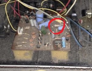

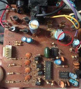

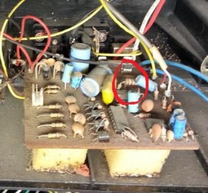

Looking to get this dang Skitronic Discolite back up and running, but I'm short a resistor, and have scoured the internet for pics of other people's boards but haven't found pics clear enough to figure out what color stripes are on this thing.
The biggest pic in the bunch is mine, though the resistor looked burnt when I opened it up a few years back (looking at it now, it looks like it may have been put on there backwards by the previous owner).

Thanks! These are all the same component, so that last one should have another stripe behind the filter cap. Would brown-black-gold-gold make sense? I wasn't looking for gold on anything but the last band, but I guess this resistor is probably from the late 80s or early 90s..
caution
Yes. It's a low-resistance, high-wattage resistor acting as some sort of current limiter. Looks like 1/2W or 1W
Don't care about the last band, it just notes the tolerance, which is probably 5% (gold band)

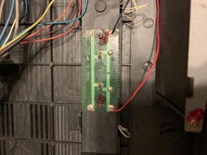

I can feed a 5v current into either of the small boards on the inside back of the unit and all the lights turn on, so my bulbs are fine. And instead of changing with volume the LEDs do a chase pattern when the disco mode is turned on. Any ideas on what to look into next? I’ll post some pictures of the current wiring later this afternoon.

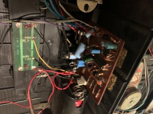

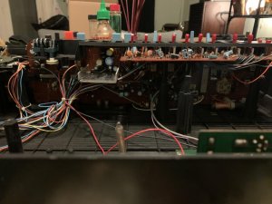

Here’s how the innards of this thing look right now. The two boards on the back are mounted 180° from the other ones I’ve seen in other threads on here (on mine, the writing isn’t upside down and the soldered contacts are on the bottom instead of the top). But taking that into account I think I have everything where it should be. Still no woofer lights or volume-tied chase for the LEDs.

flufftronix
I think there were some incorrect wirings in those last pics, but I’ve since triple and quadruple checked everything, and all seems correct.
Seems like my TDA2822M chip is fried (at this point I’ve literally seen the thing puff up some smoke a couple times!). I ordered some new ones and am going to solder in a chip inlet along with the next chip so that if any more of them blow, it’ll be easier to replace them.

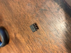

flufftronix
Removed this lil guy while I wait for the mail carrier. Thank you for your service.

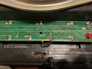

Do these things usually have botch wires on the board behind the EQ like this? The tape on top certainly looks like it could be 30 years old 😜
Board from behind the tuner.. are there usually botch wires like this? The tape on top certainly looks old enough to be from the factory 🤷🏻‍♂️

flufftronix
It’s alive! New chip is sitting in a socket soldered onto the board instead of the chip itself, so in case it dies again it’ll be super quick to replace.
Also swapped out the sand grain bulbs for some LEDs which came with pre-installed resistors that I put directly onto the boards behind the speakers, which will be easy to remove if I ever want to go back to the original setup.
Also swapped out one of the original LEDs surrounding the woofers. I tried first to sub old to new LEDs 1:1 without that preinstalled resistor, but wasn’t getting any light. But it did work with the preinstalled resistor on there! Not the prettiest inside the thing, but it’s working so hey.
