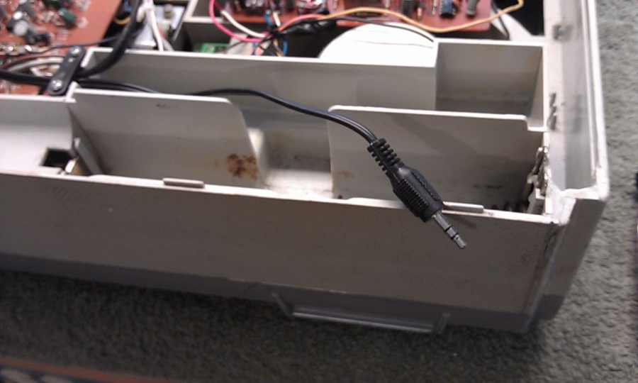

It was simple to run the connection wire into the power cord storage compartment.

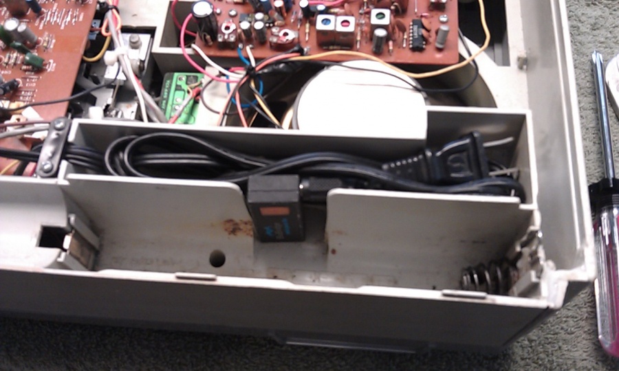

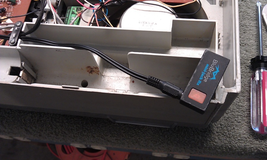

The receiver just fits in the cord compartment.

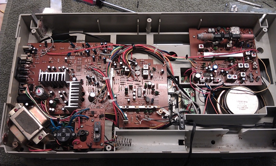

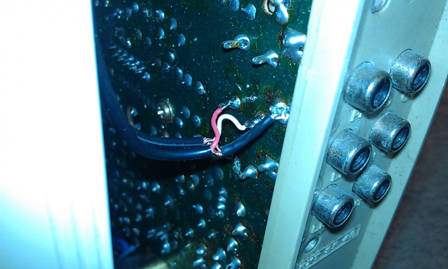

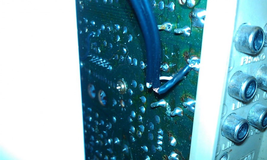

I pulled the amp board out and soldered the wire leads to the RCA AUX IN connection points.
I then zip tied the wires up so nothing will rattle and put the radio back together.

Yes, this thing is VERY small. Smaller then a Bic Lighter. BUT...It lasts a LONG time. I have easily played music for 10 hours and often forget to turn it off and have found it 3 days later still running :w00t: :yes:
