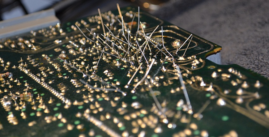

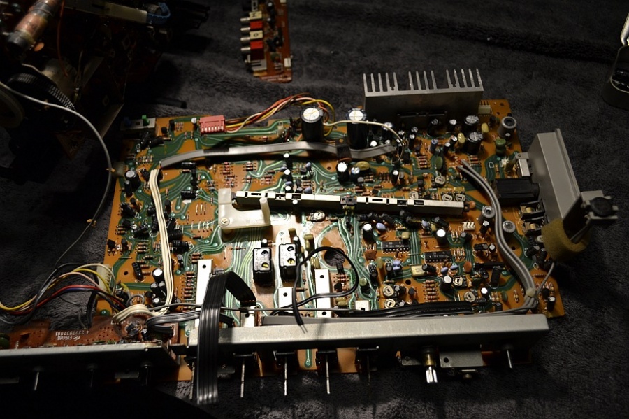

Ok. :thumbsup: Wow! Not only is it MUCH better sounding, but I actually have bass and treble control!!! :w00t:
I ended up replacing about 1/3 of the caps on the main PCB (all the caps within the vicinity of the power amp). So I'm not quite sure if it was that or the respraying of deoxit on the power and bass/treble pots....Probably a combo of both.
here is some pics of the cap replacement. It still doesn't have the brutal piercing highs that my recapped blockbuster has, but WOW is it warm and fuzzy sounding!
Thanks bill and fatdog for the advice!
