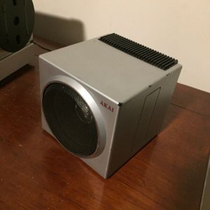

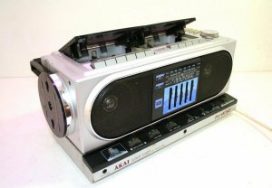

Try push inwards, lift upwards to pull it out sideways when the face of the radio and speakers are in the same plane. See the slot on the side of the unit which should explain.
The circular head of the pin is in a slot. These two pin heads are speaker connections also.
~Royce

thank you very much, it was very simple but I had not thought about it. I was afraid to break something.
