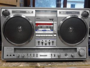

Please don't forget to take pictures of the caps showing polarity signs from various angles. These pics have helped me a lot!
The PC board got several "built in resistors" which are hard to identify.
Panny 5350 board is easy to crack based on how it is mounted.
This motor boating sound could be a crack on the board near the ground or bad cap/s. Look for any swollen top heads on caps. Some may not swell but will be bad.
It is very easy to take the board out and also the deck section. Undoubtedly it is one of the best boombox internal designs!
See those low value resistors on the board.....R141, 241, R470 and so on....

As I said this could be as simple as bad ground. Is this a 100v unit Joe? If so I would be cautious plugging it in to 120v US power source.
Bad Boy Bill
Yes its the 115-120v box and the switch is in the right spot.
Thanks for the inside pictures. Gives me an idea what to expect.
