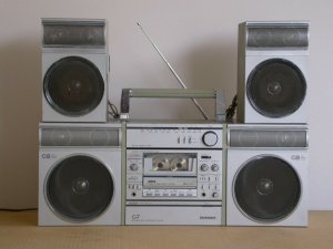

If my memory still serves me right. I saw that same mechanism in a SANYO C7.
That baby had random shut off problem, After replaced the felt on take up spindle, No more shut off and take up torque went back to normal.
This is that bad guy's picture. Yeah , It was a tough job to work on idler and take up wheel. Especially my eyes are not good as 15 years ago.

C7 c9 one of the hardest boxes to do, hats off to you Frank lad:bow:
i don't know anybody else who has successfully repaired one of these :-)
