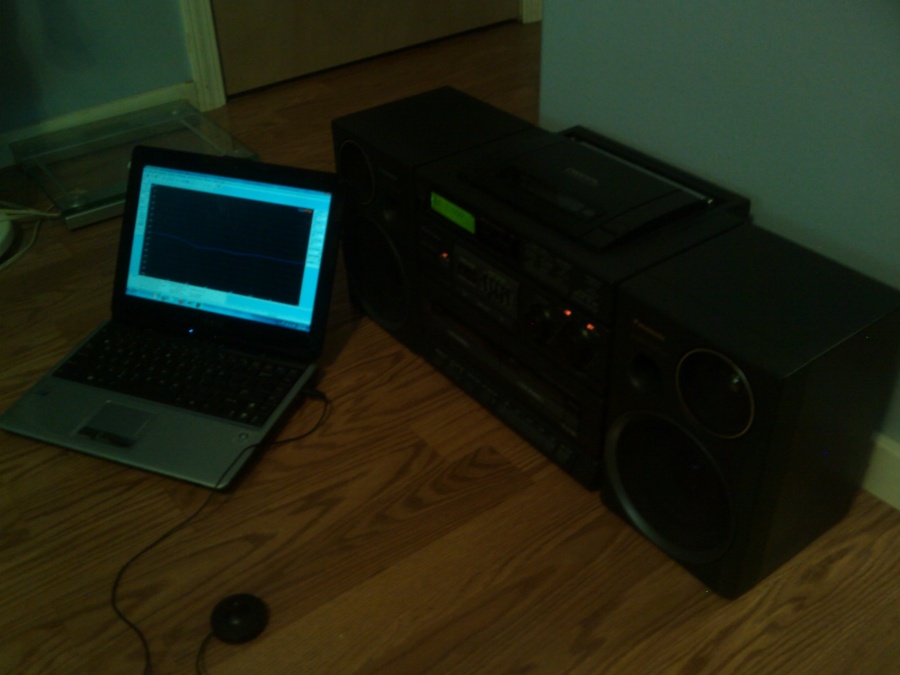

Equipment Needed:
a)My laptop that is running a program called TrueRTA http://www.trueaudio.com, real time analyzer for tuning audio gear. The free version will do for this test.
b)The mic is from my Onkyo Integra 5.9, it comes with all the Onkyo/Integra units for auto calibrating your soundstage
c)RX-DT680
For the microphone, I had to go into windows and turn off mic boost and set its level to 50. In TrueRTA, I had to setup input to L channel only, and in 'Spectrum Analyzer' I chose 'hold peak' as this will result in the program reading only the highest output levels and not show a fluctuating graph. So in a silent (seriously... as in no ceiling fan running, most electronics off, windows closed...) room, running TrueRTA yielded the following curve (no other adjustments was made beyond plugging in the mic and fixing the boost)

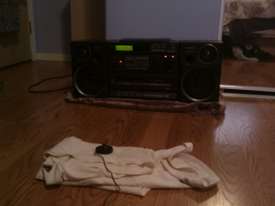

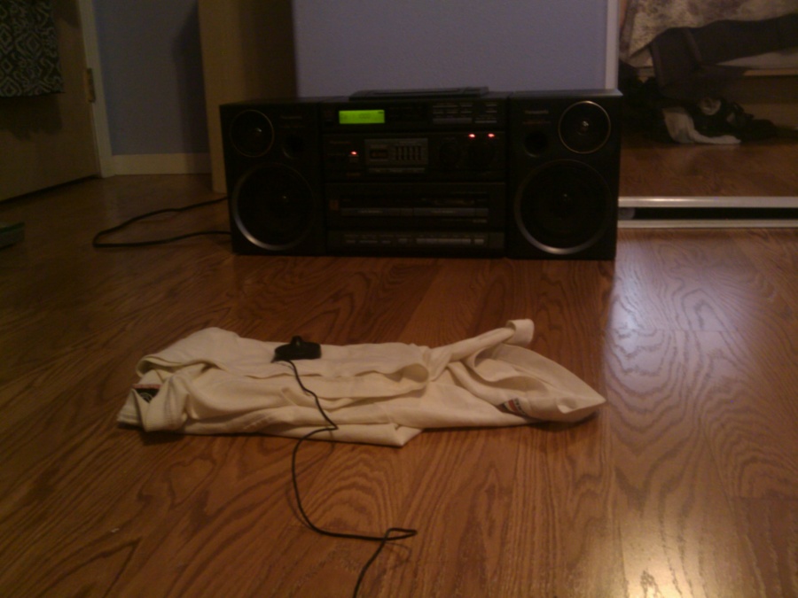

Now to setup the test environment. There are two scenarios, I will explain each one:
1. Solid Ground
In this instance, we test 2ft away with the unit sitting right on the floor. Having it sit right on the floor introduces some things, but in a nutshell - putting a speaker in direct contact with solid dense ground without any decoupling of any sort can amplify sound! (maybe that's what some want...) The mic is isolated from the ground, as you probably listen to the unit with your ears toward it and not your ears touching the ground...
2. Isolated Ground
This scenario is identical to the previous one, except the RX-DT680 is now placed on a damping material (a blanket). Simulates putting your box on grass or other surface that will absorb a good chunk of the energy from the speakers.

Testing Procedure
IMPORTANT: S-XBS setting to 0, equalizer settings are FLAT.
a)For the CD, I pressed play, hit 'Go' in TrueRTA, and ramped the volume from 0 to 2.5 max, held it for 20 sec.
b)For the cassette, I pressed play, then in TrueRTA pressed 'Go' (avoids registering the clicking of the tape mechanism), and ramped the volume from 0 to 2.5 max, held it for 20 sec.
I did both these tests for each scenario, for a total of 4 tests.
