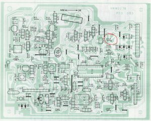

If that doesn't work, then it's probably the super cap. Check C42 on the tuner board. It's an extremely high value - 47,000 microfarads. This acts as a type of short-term battery at this level.

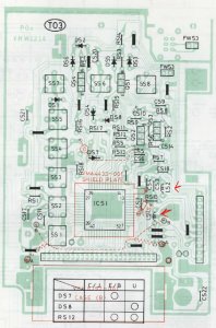

I'd be curious to know what "LS1" looks like - it's on all three models too, and sits in between the super cap and the tuner IC's power pin, on the LCD board. Curiously, JVC decided to leave it off the parts list, so there's no description for it. They just put its part number right on the schematic next to the part. LS reference designators usually refer to a loudspeaker or buzzer, but that doesn't make any sense in that spot. JVC possibly repurposed LS to refer to "special" inductors, because the symbol is a choke with a core. It may be a type of line filter. There's an identical second one on the LCD board, LS2, hanging off a pin adjacent to the one for LS1.

I see that C42 enumerated in the Tuner Board (VMW2278) in this european diagram. Still looking for a USA version. I have seen the Digital boards salvaged from time to time.

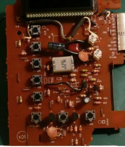

Check out the attached... looks like the Tuner board and the DTS Board are two different things. I attached a picture of a DTS Board so you can see what looks to be in that LS1 and LS2 spot? if I'm getting my landmarks correct. Could they be the two white components identically labeled as 471J or something like that?

Yep just a weird inductor, hah. Thanks for pics. 471J means 47 microhenries (µH) +/- 5%. (471 = 47 x ten to the "1ˢᵗ" power)
C42 won't vary across region, that only applies to differences related to tuning range and inputs for audio & power. I'd be curious to see a pic or know what's written on yours. Once you have the deets, go off to DigiKey or Mouser or something and snag a new one.
