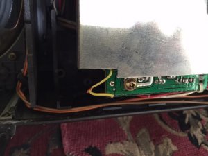

Now I opened it up and saw one wire with a cap disconnected. I could see another one with the same value grounded on one of the anchoring screws to the metal frame.
I can't find the place where it is connected to...
The lower part of the yellow wire is disconnected..

Sanyo radio tuners often go bad over time. It's either that or just a dirty contact. Hopefully it's the latter.
It went through a good contact cleaning procedure by squirting in those top holes over the switch and working it several times.
This is not a user friendly box design at all. If not I would have took it all apart and cleaned it well.
I am obsessed with the sound quality of this box and I am afraid this would become my fav box after having more than 130 of them including many high end ones.
I don't care if the cassette needs belts and all but what really bothers me is that I cannot tune in and FM stereo station without playing with the mono/stereo/wide flip switch.
In the worst case I will keep it for line in listening. The sound is just amazing!
