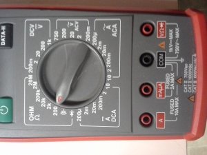

If your multimeter is only a basic model, you will need a capacitance meter to test each individual cap (after you have desoldered it). I bought one from Ebay for $7 and it works well. I checked every cap on a M9994K and found most were stuffed. I then checked the meter by testing brand new caps and they read as slightly higher than spec.
Hopefully it's only your ancient Lasonic speakers at fault.

Here's my multimeter... I wouldnt call it basic, but maybe just basic enough not to be able to huh?
