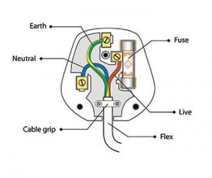

I'd make sure the plug is wired up correctly! Though the fuse in the plug or on your home circuit should blow if it's wrong
Yeah, it was wired correctly and I don't think the plug has been off in 20-odd years (which is about how long I've owned it for). It doesn't have an earth as per your diagram though. It's only a 2 core cable. Like I said, it's been working fine up until a few days ago. Grrrr!

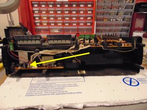

It may be your AC Mains filter capacitor. It's located on your power supply board (or section of the main board). They are usually fairly large ones. As capacitors are relatively cheap this is a no brainer. Keep in mind that the power supply capacity is not governed by the quality of your capacitors and adding larger or higher spec'd ones will not increase the current carrying capacity. That is determined by the size of the transformer and the size of your rectifiers. Most bluetooth devices don't use that much power, but if it's not switched, then it's on all the time.
I would suggest replacing all electrolytic capacitors in your PS board. I changed all of the capacitors in the entire boombox on my Hitachi, it's not that many actually and fairly easy to do on this model.

Thanks Superduper, I really appreciate the assistance. Would you suggest replacing them like-for-like or should I put slightly higher capacity ones in instead?
For the boombox as a whole, replace them with same uf caps, higher voltage and temps are fine. For the PS, you can probably get away with using slightly larger caps (value wise) if you like, but be aware that doing so will add additional stress to the transformer due to the inrush current during the charge cycle on higher uf caps will result in larger current surge. Typically, the next step larger can be 50% higher capacitance (i.e. 2200uf caps, next step up is going to be 3300uf) so that is substantial. Buy from reputable dealers only. I don't suggest getting from eBay or Amazon or anything like that. Made in China stuff are likely going to be subpar or seconds/rejects if they are sold on eBay or Amazon. Name brands are your best bet. For example, if you get Panasonic caps, you can't go wrong. But many folks are not familiar with the names of mainstream capacitor brands.... if in doubt, google the name and see what you get.
