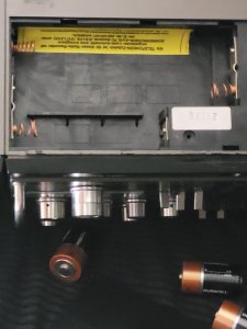

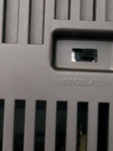

Having issues with my Studio1 it will run on batteries can't get it to work on electricity and no lights work except the stereo light if I plug it into my power converter with batteries in it the dial light will come on and 1 of the cassette meter will light up and if I take 1 battery out it will not power on anyone else have these issues? And also can the lights be changed out to led ?

Check the leaf switch inside the AC input. It activates when you insert a power cable. It might be corroded.

Sounds like it's not getting enough power. What voltage are you feeding it? Have you set the fuses to that position? There is one position for 110V and another for 220V.

Had it set on 220 but I think think it's 240 my power converter is 220 gotta buy some more fuses I think you have too hook up 2 fuses for the 110
