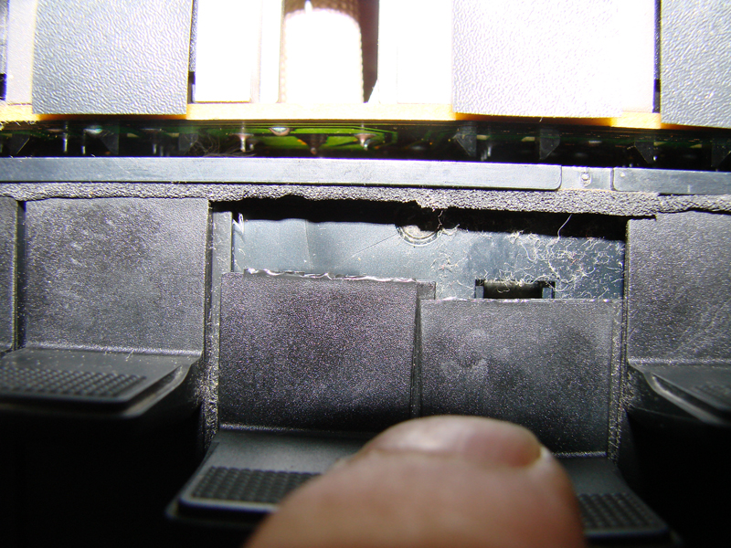

so i hit a brick wall.... getting all the connections deoxit-ed, only to find out that its not the power button. now it seems that the sound only become true when I press the tape play button half way down until it makes the box sound almost pop. The tape player will override all sources when the play button is pressed all the way down. As soon as i press a half press play and let any other source play, it fixes the crackle sound. keep in mind the crackleing sound is intermittent . usually after a few minutes of true sound. Is there a contact for this play button? If so, seems difficult :-/

forget it fellas :sad: :sad: :sad: I'm not worthy of fixing this unit. I forgot to mention a while back that it's only the left side that has this problem. I've done the best I can to my ability. It seems to me like this unit is ****ed, but to someone else it would be an easy fix. Anyone want to fix this unit for me? :sad: I love this Telefunken
