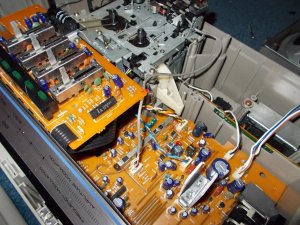

So for a while, I've had a problem with this Panasonic RX-5050 boombox I have. I suspect the issue lies in the cassette head somewhere. Whenever I press the play button, it makes a very loud noise that sounds somewhat like an explosion or a thunderstorm, and a faint hum can be heard in the background as well. I also have the same exact issue on a much smaller Panasonic RX-4955 boombox. Here's a video of the problem:
http://youtu.be/KO-XSl6OP_I
I know it's exclusive to the cassette mechanism on the boombox because both radio and line-in inputs work just fine (as seen in the video). I've cleaned all switches and pots repeatedly. This problem also goes away when the tape head connections are tampered with, so I'm assuming it's an issue in the wire. Anybody else ever had this problem?

Clean the long record switch on the PC board with Deoxit and see if solves the issue.
I'm going to guess you are speaking of the one with the gray wire, correct? If so, I've cleaned it multiple times to no avail.

Boomboxlover is referring to the long metal housed switch that has a plastic actuator that is spring loaded on the circuit board that a metal tab or connecting rod from the cassette deck record switch taps and moves when you push record. Spray a little contact cleaner in the switch (you may have to remove the cassette deck to get access to), and then get a blank tape and record something from ipodline in, radio,or just line in. Exercise the switch as much as you can. Any plugs that you can disconnect and reconnect, do that also. Sometimes oxidation builds up on contacts and prongs and it causes all kinds of noises. Give it a try.

Thank you so much, BoomboxLover48! Simply messing around with the record switch itself worked, but now I will also give that a spray.
