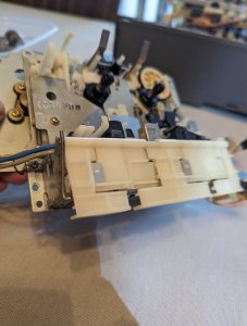

Stripped it down today, gave the case a bath and can see the play button is stuck in. I can't see any reason for it so may need to strip the mech down. Possibly a linkage has come out of position or moved and blocking the return

That's an odd looking setup for the buttons.
Hopefully it turns out to be something easy.
The stop button partially releases it, just not fully. Must be some lever or gate not connected or not aligned properly. I don't really want to strip the mech if I can help it but it's looking that way.

There could be some friction due to old grease under the Head assembly.
Yep possibly, some slide or lever not moving and locking it in place. I'll need to dig out my glasses and have a go at stripping it down but I need a bright day and fresh eyes to do that kind of work nowadays lol
Take a good look at the mechanism when the stop button partially releases it. Identify the levers that are moving in the process and try to gently maximize the travel of it in both directions.
Basically, there is a play mode connecting lever section that locks in the play mode, and the stop button is not fully releasing it. I've been through many problems with the deck mechanism, and it is a pain to identify which part is causing the problem. As long as one doesn't use any excessive force or pry a lot, things will be fine. You will soon figure it out! Good luck!
I've got some time this weekend to have a good look at the mech and strip it as much as I can, from first view there's not much visible.
