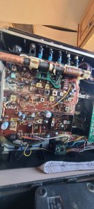

I have a 9994k that suffers from weak FM signal. I can't tell what capacitors need to be changed to improve the reception. Any help would be greatly appreciated.
You might have a hot joint on the aerial. Try to clean it first with fine grade sand paper and grease. This is were the wire screws on to the aerial base.
