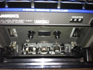

Here is a picture of the cassette deck. I wanted to know if it all looks in order? Are there supposed to be 2 pinch rollers? and which screw should I adjust to stop the distant, muzzled audio sound when playing cassettes? The speed seems fine as I can hear the cassettes at a regular pace but it's just that it sounds like I'm listening to it through a wall or something. Thanks again!
scarletruby
Jul 20, 2014
13
I just cleaned the cassette tape head and pinch roller and now the sound is back but it goes in and out a bit, does it need more cleaning? any other parts that I should clean? thanks!

Hi and welcome!
The 5050 has a single direction deck so no second pinch roller needed. Cleaning the head was the first step. If the sound is clear now from both channels in output level and tone then the head should be ok. Is their any signs of wear on the head surface? A dry, flat spotted pinch roller can cause the tape to drift a little as it contacts the head causing that 'coming and going' sound output so a new one may in order. The head may need adjusting but unless someone has been tinkering in the past, it probably doesn't need adjusting. Those decks are pretty simple and plentiful so parts shouldn't be an issue.

There doesn't seem to be any signs of wear after I cleaned the tape head. It now looks shiny and clean but the pinch roller does look a little worn and stained with residue. I'll look online for a replacement, any suggestions of where to look? thanks for all the help!

I'm not sure where to find a genuine new replacement. You could possibly find someone who has a used part in better condition. Be careful when you pull off the black plastic 'plug' that holds that roller assembly in place. The small hook at the end can be damaged upon removal and then won't hold the roller in place properly. The decks on these Panny's are a bit cheaply built in comparison to the older models.
I've got a spare roller here somewhere but it's probably better if you can find one locally.
Screw shown. It is basically to correct the misalignment of cassette magnetic recording track with respect to the head - that is to make them perfectly parallel.
You will notice that one side of the head is fixed and other side is fitted with an adjustable screw on a spring.
To make it to the correct setting, you need to adjust it while playing the tape. Most decks have a hole aligning with this screw to adjust it while playing. See if there is one.

To be honest, that pinch roller looks fine to me, just accumulated some residue over the years that looks absolutely normal. You can clean that roller to make it look and perform like new again, which is what I would recommend. Removing that roller also involves a bit of risk and if you don't know what you're doing, could cause more harm than good. The simplest thing to do is buy some of the long swabs available at electronics repair places or online. They look like regular q-tips but the tips don't shred easily and are stiffer, and they are much longer to allow you to reach. Use 100% tech grade (or strongest you can find) Isopropyl alcohol and scrub. That should restore the grip to like new.
As for the adjustment screw, I don't suggest you go there either. That setting does not change from factory unless someone tinkers and adjusts it when they should not. Once set by the factory, the screw is coated with a setting compound to prevent change. It is usually adjusted from factory with the aid of an oscilloscope although I'm sure some folks here will tell you to adjust it by "ear." However, that won't give you 100% accurate setting. With the aid of a scope, you can actually see when the heads are in perfect phase.
Keep in mind that a lot of older tapes won't perform like new anymore. I have some tapes that looks fine but have so much friction they cause the deck motor to stop in it's tracks. Playing a different tape is no problem. Trying to fix that would be like chasing ghosts. Record a new tape session and replay it. If the "new" tape works well without the issues you mentioned, then forget about messing with the mechanism. It's probably the tapes.
Did you demagnetize your heads yet? A lack of high frequencies is frequently a sign of a head that needs degaussing. Also, you should try the record bar cleaning trick. That is to engage/disengage the record function many times (as much as 50) to try to work oxidation off that switch. Over years of unused, oxidation builds up which inhibits proper signal strength from passing. A better way to clean it is to introduce some solvent into that switch but I would suggest employing the trick above first to see if there is any improvement.

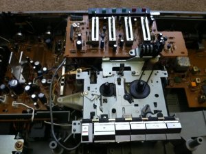

13
Okay, I finally took a part the boombox and now I'm staring at the cassette deck and I removed it but I'm not sure how to clean the record switch. It is stuck and doesn't push down like the play switch or other switches and I've sprayed some contact cleaner but maybe I'm missing the right spot to spray. So where exactly should I be spraying the contact cleaner? Thanks!
PS: I've realized that another user has also repaired their RX-5050 so I've been reading through that post and trying to apply those methods to my boombox as well.
Beosystem10
Feb 21, 2013
1,807
3
59
UK. 55.7710° N
Are you sure the record switch is stuck? Apologies if I'm stating the obvious here but you did push the record protect tab up didn't you? The record switch doesn't move without that out of the way as if a tape with its write protect tab were in there, this is to prevent people recording over prerecorded tapes, which don't have the tabs. ;-)
