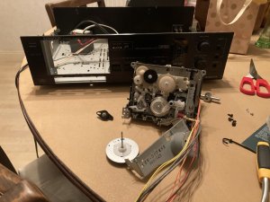

I decided to just go for it this afternoon and ordered a big bag of belts. I’ve got the deck out and have now cleaned up wherever they’d stuck and have the pinch roller out and cleaned too. Can you tell which cotton buds cleaned the pulleys and which the heads and rollers? I obviously took clean heads seriously as a young man!
