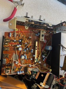

Use SBO7.0 for the counter and FBS9.9 or FBS10.2 for the main belt! Thanks to caution (Eric). I went with FBS10.2.
Here are some pics...clutch mechanism was not put in place when I took pics, so it is missing there.
Clutch mechanism is missing there ..
