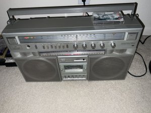

I have been searching for the impossible, a clean Realistic SCR 8 but I found it yesterday and now I’m waiting for it. It has the typical issue with the heads being stuck but since I have experience with working on its brother model the Blockbuster 3-5259A, I should be good. I have seen a lot of SCR8’s on eBay that are missing the meter plate and cassette door. I’m thinking I might take a stab at recreating those two parts, depending how much time it will take and money. Thank God I got into 3D printing because I have made so many replacement parts for some of my boxes. Just working delicately with the Blockbuster I’ve broken pieces off the cassette tray and that flimsy tab that holds the metal plate that hides the idler mechanism. Time to gather the parts I know I’ll need and looking forward to a new project. Peace to all who love Boomboxes!

I've had 6 or 7 SCR-8s over the years (none right now) and one blockbuster.
All were in very good to great condition but it's tough to find them like that now.
They're nice boxes to work on with plugs to separate most things unlike some that have soldered connections all over.
Every one of mine had the broken plastic spring retainer piece under the heads.
It's amazing that so many people tossed the doors in the garbage when the plastic hooks that held them on broke.
A couple dabs of glue could've been substituted.

Just unboxed a very clean (outside) Realistic SCR 8. The box is scratchy on all the knobs so some Deoxit is prescribed to remedy the situation. Radio and meters work but it is dusty in the headers area and the heads bracket is broken but I have my parts and will drop some photos tomorrow.

Just got finished installing the SCR 8 parts needed including belts, 3D printed heads plate, pinch roller, idler tire and some light oil( so happy to not have a broken idler gear). When I was disassembling the cassette door (I was being gentle like I do with the Blockbuster) and cracked two tabs on the right side. Luckily I found the broken pieces and super glued them back. Inside the box it was a bit dusty and it appeared that the box hadn’t been opened in a long time so I dusted her off. The main belt had some miles on it and when I went to install the secondary belt I discovered that the belt was melted everywhere. All that time spent with my Blockbusters paid off because everything works great (except rewind for some reason).The VU plate came off right as I was tightening the last screw so I put it on my scanner and saved a copy of a high resolution scan for possibly recreating it. Might also take a stab at the door replacement because Ive seen so many boxes missing those parts. I’m rocking some Buddy Guy and this box rocks, my new favorite.

Looks like a nice box if it is working like they described.
Not sure if the antenna is there but the rest looks in tact and pretty good for anywhere around that price.

i just watched a video of one of these being repaired, the cassette decks are good Quality and well made, but they are supposed to be a nightmare, 1, the plastic mount that the head and erase head are screwed to is under a lot of pressure from the spring that raises the heads and it snaps off, the video i watched, the guy had to repair 2 of them with JB Weld and even then it didn't look that great, he said it was a common problem, and the second thing the guy said was, there is a small cog that runs the play spool, that splits and there is no fix for it.. i'm Quite devastated to see it because i love the radio and always wanted one, if you didn't know of the deck problems just be aware..
