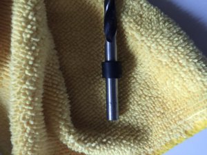

I used my drill as the lathe and the right size drill bit for the milling need.
Slipped the cut section of the tube on the back end of the drill bit. Then I glued 400 grit emery paper on a wooden ruler for the grinding.

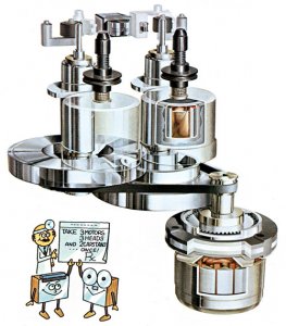

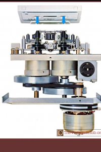

This Akai GXC 570D is real monster. Please give us more info i pictures.... :yes:
Goodman send me a PM with your e-mail ID. I can send you lots of info on this deck. If I put all that here I will get my butt kicked by admin and moderators. :w00t: :lol:
It is one of the best Decks ever made. Touch sensor play functions and have wired remote also. This deck had two capstan and two pinch rollers. When it works you don't see or hear a thing except the tape reels moving. They got the large motors like in 735D. I believe they are brush less motors. The sound quality is amazing!! It got 3 heads 3 motors and two capstan.
