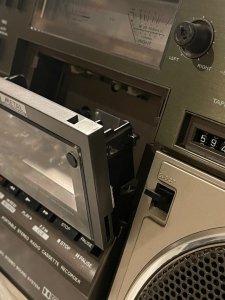

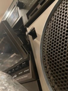

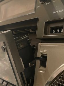

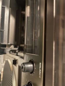

I made a replacement latch with Epoxy Putty.
New belts and cleaned up the mechanism, tape works now.
Still working on the case, painted the rusty speaker grills. The perspex are scratched, not sure how to fix them.

Nice job so far, especially that door latch.
They do sell clear plastic polish if they're not too deep.
If they are, wet sanding with light grit sandpaper will take them out.
You have to progressively get finer until you can polish the sanding marks out.
Basically the same as what people do with scratched and cloudy plastic headlights.
