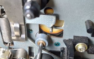

Here's the section I'm talking about although I'm sure you already knew.
It's hard to tell in the pic but this is in 'Play' and the tyre is probably about 0.5mm away from the capstan.
EDIT: I found my answer, I am indeed missing a part there; a rubber tyre that goes around the capstan.

Is the capstan itself suppose to have its own rubber tyre around it? When re-assembling I noticed that when I pushed the capstan though there was a large amount of black goop caught up inside the cut-out so I assumed maybe the capstan had a tyre around it which makes contact with the idler tyre - is that correct? Or is it meant to be that the idler tyre makes direct contact with the capstan?
the capstan had a tyre around it like a tube. Part no. NPLYR0050AFZZ
