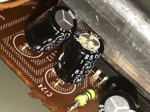

Floyd, You were right!
Found the culprit! I hope that is it. I will replace that and see how it works. In that process I will look for more leaky caps.
One 100uF/16V cap near the power ICs is leaking.
It is the cap connected to the Channel 2 of IC 302.
There are 4 caps of the same value around the IC
C 124 (leaking)
C 125
C 225
C 317
I will replace all of those 100uF/16V caps.

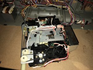

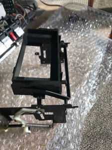

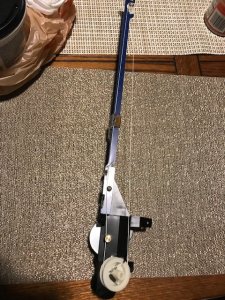

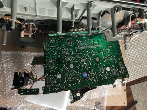

Received all caps and this evening I removed the dial cord assembly and the deck. Now have to remove the main PC board. I will post pics as soon as I am all done.
Main belt flat belt is elongated. I believe I have a 10.5 medium flat belt somewhere. bad planning.... I should have ordered belts also before dismantling it. Anyway belt changing is not that difficult on these SONY CFS models.

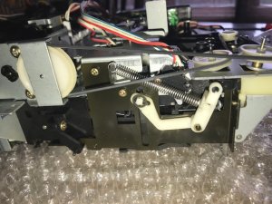

The next hurdle is the belt replacement on this. These SONY decks are a nightmare to work on. I've worked on all the CFS decks, but I am always nervous working on it. The top plate for the flywheel will not come out easily. One has to remove several parts and components to get there.
I am waiting for 11" and 10.7" belts.
Original belt was slightly elongated. It measured 11.5" as it is.
Sadly our belt reference guide gave wrong numbers...10.5".

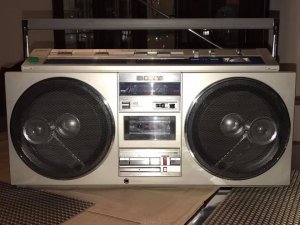

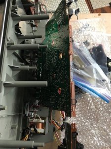

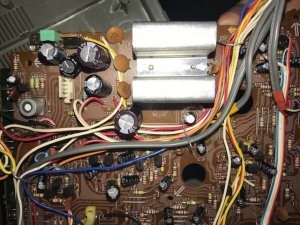

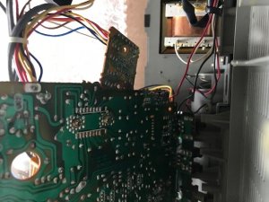

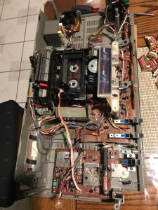

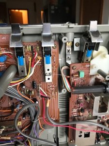

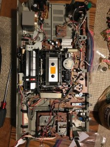

Pics...
Replacing with new caps one by one...
Excellent radio reception and nice sound quality. Decent bass at low volumes! One great Sony to have in the collection.
Now I have most of the CFS Sony in my collection.
