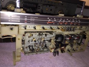

Hi all,
Just thought I'd post about a Big Ben deck problem which is fully working other than the motor and pitch control. The deck is playing fast so I checked out the pitch control and two resistors R779 and R880 but they check out fine.
Anything else I could check to cause the motor to go so quick during playback?

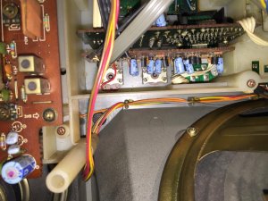

Yeh I have access to the board but it's a stiff pot and I've cleaned it. The manual doesn't provide voltages to check which is usually a good place to start.

Hi Norm, I tested the ohmage of the pot at the two pins on the pot board where the wire goes to the deck board. I disconnected the cable also..
I saw it change between Oohm and 4kohm when turning the pot.
Presuming the motor is shot? :(
