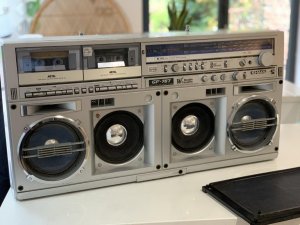

I’ve had this 767 for years, found it locally in a 2nd hand shop from memory, didn’t have any cassette doors on and most of the knobs were missing. I bought what I could on eBay bit by bit to get it looking reasonable, then stuck it on a shelf in my office and left it there...
Anyway, I’ve decided it’s time to get it to actually play nicely!

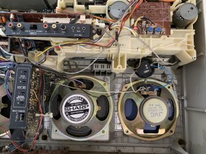

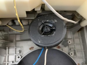

Everything works, just not that well. Lights come on, tapes play fine but it sounds poor - muffled, lots of static/ crackling when you change the volume. One of the speakers has a tear in it (which had been repaired with duck tape!) and a tweeter has fallen off.
So, I’d like to start with the speakers and perhaps an overhaul of the tape decks. I’ve done lots of searching on speakers and can see people trying various options so I wondered if someone can tell me what parameters I need to stick to when looking for replacements?

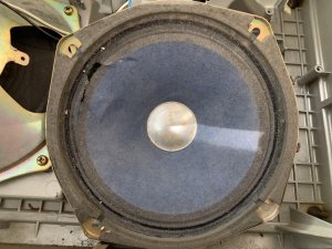

Which speaker is torn? If it's one of the JVC speakers, you should probably get rid of them anyway, because they're more restrictive than the originals. You can see on the magnets they say 8 ohms, while the originals were 4 ohms. This means they will constrain the maximum volume you'll be able to get from this.
Also, unlike the 777, I don't think the 767 originally had tweeters, so the one in your photo was probably added by the previous owner, and who knows where he got them or if they're any good.
You should be able to find original speakers on Ebay quite easily (or from a member of this forum). Or, if you're willing to lose the "vintage" look, you can use aftermarket speakers, as several members have done.

The JVC speakers don’t look like they’re original anyway, so unless I can source some of whatever should’ve been in there I’ll have to find something else to fit!

The torn speaker is indeed one of the JVC ones and they’re obviously not original now you mention it!! That said this is the first of these I’ve ever opened up so wasn’t sure if maybe there was a shared components thing between Sharp and JVC... Obviously not though.
Once I get access to the For Sale section I’ll keep my eyes open for some original speakers and replace the JVC ones. Failing that it will have to be aftermarket.

Yeah those blue ones are from a JVC M70. Good speakers, but more restrictive than the originals.
