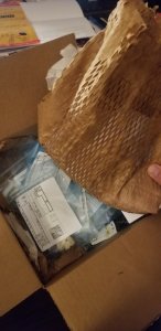

Parts identified and ordered from Digi-Key. I counted 59 electrolytics and ordered the correct capacitance and tried to match voltage and exceeded it if the match was not available.
