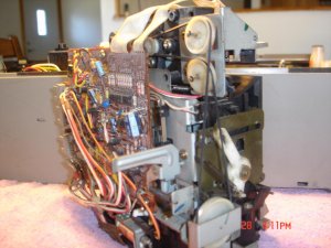

From what I remember you don't have to remove the deck out for belt replacement (I could be wrong!). You can easily change it from the rear side of the unit.
Here is a picture of it. From CFS 77 and up they all use the same belts. The deck section is the same except for the LED display tape search added on CFS 99.

DrmZ
Thanks! So I can use my 77 as reference. That helps a lot.

I changed only the small belt. The flat one was looking fine. The rear section with the AMS board will come out to access the flat belt. It is a little tricky. Take pictures when you remove it for reference purpose.
I forgot to take pictures of accessing the main flat belt. Other members might have pics of it and more details on the main flat belt change.
