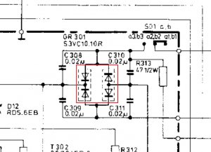

I have exchanged the three large caps but no success. A friend told me to try and exchange the diodes next. Does anybody know a source where to find these two? S3VC doesn't bring too many useful results on google.
In case you will not be able to find replacement diodes (i was not able to find them), you can make your own rectifier bridge.
I have no clue what I have to do but I am willing to learn, will dig into that and report. Much appreciated, thank you!

Instead of changing diodes (which probably will not fix the issue) take a look at those 4 capacitors with 0,02uF. They are around the diodes. There is a possibility that they are shorted, that's why you have disorted sound at low ranges.
Yeah, I figured that it might not be the diodes and was pointed to transistor T301. Very hard to find as it is screwed to a cooling element! I saw that around this transistor there is black smut on the resistor beside it and on the board. So my guess now is that the transistor leaked and I ordered replacement for it. Waiting for parts ... again. =)
The whole unit was covered in white fluff like it was standing near a cloths dryer for years. Maybe that trapped the heat inside it and the transistor overheated?!
Your suggestion is still helpful as I will change those caps if I have the right replacement caps at hand just in case.

Just to give an update, I exchanged the four ceramic caps around the diodes with no effect. I also replaced the transistor T301 and some random caps which I had available, also with no effect.

I exchanged more caps and found a short in the flat cable. The distortion seems to be gone on one side, the other speaker still distorts. So close ...!
There are two 3 pin rectifiers I would like to replace but I cant find replacements (brown and black, see picture above). I don't know how to build my own rectifier so I am putting this unit away. Maybe I can use it as a spares unit or I will eventually throw it away. Thanks for the help everybody!
